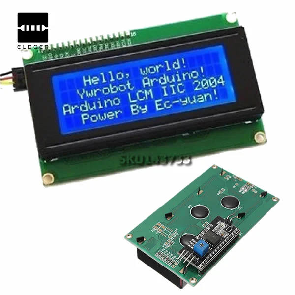

We've also attached a LCD Display showing time and temperature [coming from the internal temperature sensor in the RTC module].

RTC Module LCD Display Arduino
VCC VCC +5V
SDA SDA A4
SCL SCL A5
