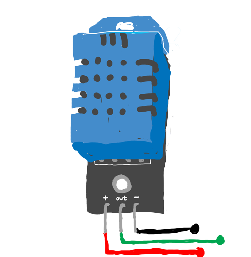

Wiring Things Up
Start by connecting the radio module.
Sensor Arduino Comment
- GND Marked black
+ VCC (3.3 - 5.5V) Marked red
out (middle) Digital pin 3 Marked green
